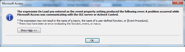

I have made a macro for the search of an entry by the value of a particular field. It worked on one computer but when I try to launch it on the other I get the following error. On could be a reason of it and how could I solve it?

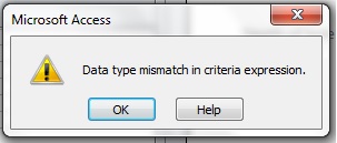

Also, this might be off topic but I also get the following error when I launch the query that contains the field with the Date type. Could you help to solve this?

    One possible reason you are getting the error on the other machine is that the code doesn't compile on the other machine because of the DataType mismatch error.
    Datatype mismatches are easy to diagnose. Since the only match I see is in this line:
    Me.Recordset.FindFirst "[Kodas]=" & kodaspa
    I suspect that Kodas is NOT a Number datatype. Or that the control kodaspa contains other than numbers. And I agree with Tom to use Me.kodaspa

    Access does not have fields with Date data type. Did you mean Date/Time, or are you perhaps leaving out that you have a SQL Server back-end with a Date field?

    Part one appears to be a Reference issue, have a look at...
    http://www.access-diva.com/d5.html
    I would just looking at the ones on the machine that works and compare to the one that does not work.
    Part two... can you post the SQL of the query?
