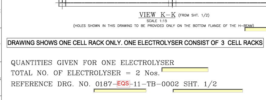

i have added several combo boxes on a image which are linked to cells (from various spreadsheets) and the value is dynamic.
combobox are grouped with image
for example
group A consist 1 image and 10 combo boxes
group B consist 1 image and 10 combo boxes
both groups are placed at same location
VB code hides one of them based on value
either group A or B is visible at a time
as soon as the value changes in the linked cells the size and location of combo boxes  changes.
they move from the location to a random location when code runs and size is also changed.
please recommend me the charges which i need to do in code/excel to avoid this.

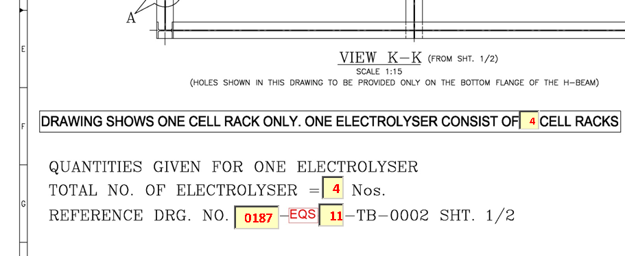

OssieMac 48,001 Reputation points Volunteer Moderator
2016-04-02T04:34:38+00:00
After you have the combo boxes correctly positioned, you can run code to save the position and size of the combos on a worksheet.
You can then run code to resize and position the combos based on the saved data.
In the following code examples, the first sub creates a worksheet to save the position and sizes of the combos. You only run this code once after the combos are correctly positioned.
The second sub can be run anytime to reposition and size the combos.
Don't know how competent you are with VBA code but as a suggestion, you can place the reposition code in the worksheets module under the Worksheet Activation event so every time the worksheet is activated, the combos re-position and re-size. However, don't place it in there until after you have run the code to save the location and sizes otherwise it will error because the worksheet with the saved data will not be present. There are other options for where the code can be placed so it runs automatically but without your workbook and knowledge of your project I am not really in a position to determine the best setup.
The code is not tested in office XP so I cannot guarantee it will work. Make a backup of your workbook before installing the code.
Feel free to get back to me with any questions.

    2016-04-06T06:41:52+00:00
    dear Ossiemac,
    thank you very much for your valuable feedback
    i tried the code.
    it works fine.
