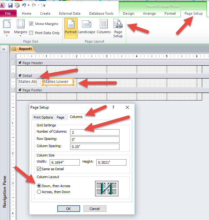

  5. ScottGem 68,780 Reputation points Volunteer Moderator
    2016-04-17T01:50:22+00:00
    You need to look at the whole screen. The first screen shot shows a report open in Design mode. There are arrows pointing the the Page Setup tab on Report Design Tools and then the Page Setup dialog (or you can just choose the Columns dialog.
    There is another arrow pointing to the Detail band of the report. Controls are objects placed on a report that may or may not be bound to fields in a table. In this case the report is bound to a table of US States and I placed two controls for the state abbreviation and name. Below the Page footer is the Page Layout dialog displaying the Columns tab. Not that I have it set for 2 Columns and the layout for Down then Across. Note, I forgot to change the Column Width, it should be about half the page width.

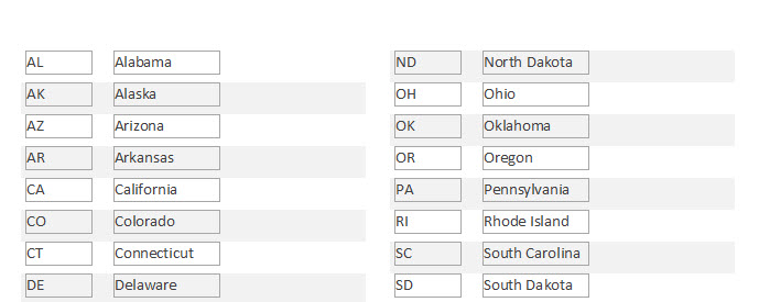

    Following is the results of this setup in Print Preview mode
    That is what you asked for, isn't it?
