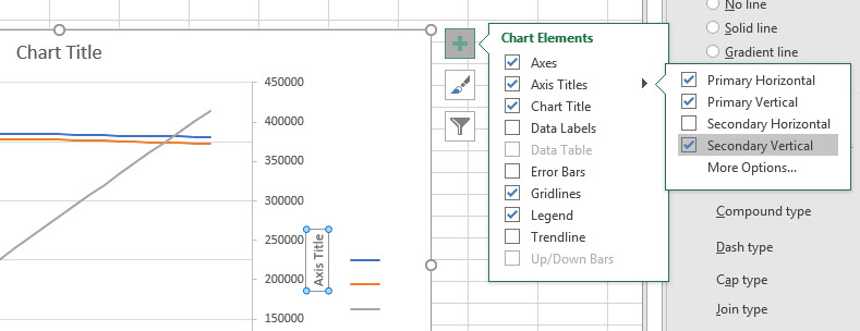

  5. Anonymous
    2017-03-16T09:24:15+00:00
    Here is how I made it by browsing the Help function in Excel:
    1. Click in the plot area
    2: Click the green "plus" appearing to the right
    3: Hover "Axis Titles" to get the black arrow point to the right and then select the option "Secondary Vertical" from the new pop-up menu.
    You should now have an axis title to the right hand side secondary axis.
    261 people found this answer helpful.
