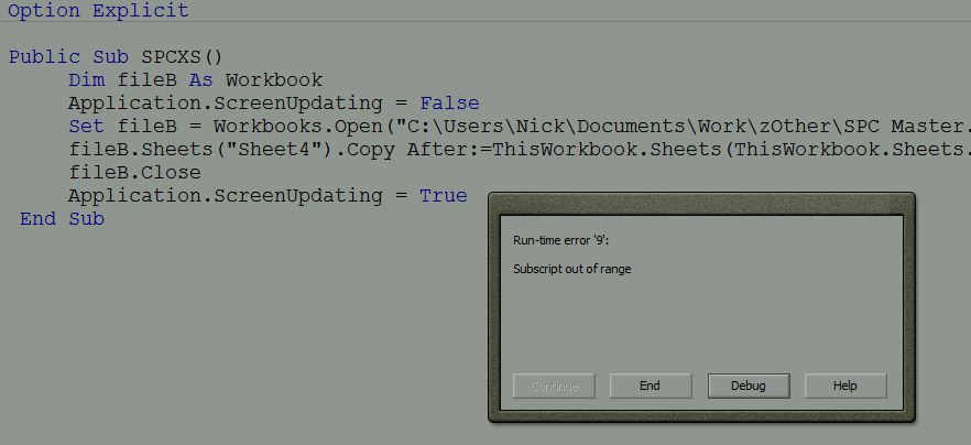

    2015-07-17T03:14:57+00:00
    The error message means "Sheet4" cannot be found.
    You should make sure the worksheet "Sheet4" is present (the name you see in the worksheet tab), and do not confuse with the underlying worksheet object name

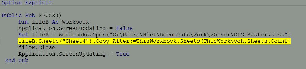

    2015-07-17T02:58:09+00:00
    Hi Wyman,
    Corrected but now have the following problem, can you help?
