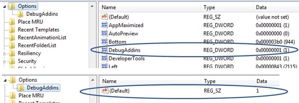

I'm trying to revive an old project from way, way back. I've found both a ppt and a ppa version of the file. I've set my RegEdit using the instructions here http://skp.mvps.org/ppafaq.htm#6 (hopefully I did it correctly-see below, I wasn't sure which way was correct so I did both)

Image: where I set DebugAddins per the ppaFAQ

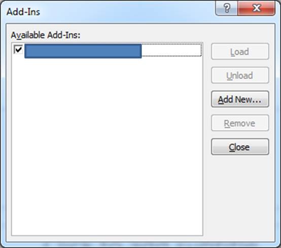

    In powerpoint, I removed all add-ins (not just unchecked, but actually clicked 'remove' in the userform). Confirmed there are no add-ins showing in that dialogue box.

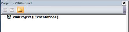

    Alt-F11 to open the VBE
    All I see is the blank file from when powerpoint loads, no code modules and nothing at all referencing this file that has just opened. Note that this file does not have anything visible in the main powerpoint UI either
    but the add-in is now loaded:

    It's hard to tell from your screenshots whether you've added DebugAddins in the correct place.
    It should be here:
    HKEY_CURRENT_USER\Software\Microsoft\Office\14.0\PowerPoint\Options
    Rightclick Options, choose New, DWORD value to add DebugAddins and set its value to 1.  Your second example should be removed.
