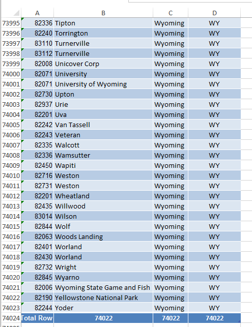

    2016-01-20T19:38:16+00:00
    hi
    saw that ZIPCODE is formatted as TEXT in the file so changed my code to below but still getting MISMATCH type 13 erroror.
    again, thanks!
    Private Sub txtZip_Change()
    Dim FindValue As String
    Dim FindWhat1 As String * 5
    If Len(txtZip.Text) >= 5 Then
    FindWhat1 = Left(txtZip.Text, 5)
    FindValue = Application.VLookup(Trim(FindWhat1), Sheet2.Range("A1:C74022"), 2, False)
    txtCity.Text = FindValue
    End If
    End Sub
    2016-01-20T18:45:15+00:00
    hi
    actually was trying that approach first with a similar file i found using  code below.  keep getting MISMATCH (13) error. and i saw also saw posted somewhere that since a lot of duplicate zipcodes the approach won't work anyway.
    how do you access this file in your code?
    thank you very much though for the quick reply. :)
