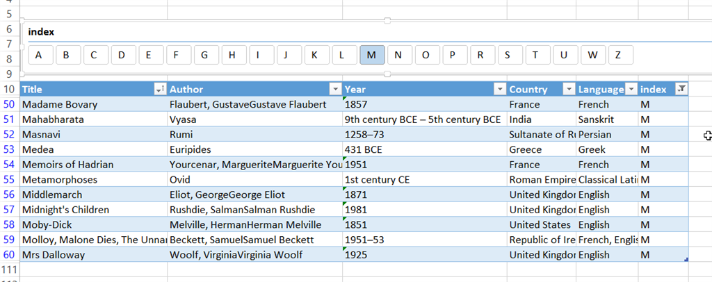

Hello,
one other possibility, no code, works in Excel 2013 and up:
  • Turn your list into a table (Insert Table)
  • add a column that has the letter index. You could use a =LEFT(Title,1) for that
  • Insert a slicer for the index column
  • format the slicer to have 26 columns and make it wide enough to show all the letters.
  • position on top of the list.
  • regardless of the sort order of the list, one click on the slicer will return all titles that start with that letter. You can also Shift-Click to select contiguous letters or Ctrl-click to select non-contiguous letters.

>> Will I be able to control the size of these buttons?
These "buttons" are as wide as they need to be to show the text they need to show. Think dynamic sizing.
>> Can I set it to two rows of letters A-M, N-A?
You can control the number of columns on the slicer. By default a slicer is 1 column wide and shows all values in rows.
You can set how many columns the slicer has. If you want A to M then set it to 13 columns, and everything after M will be plotted in the second row.
