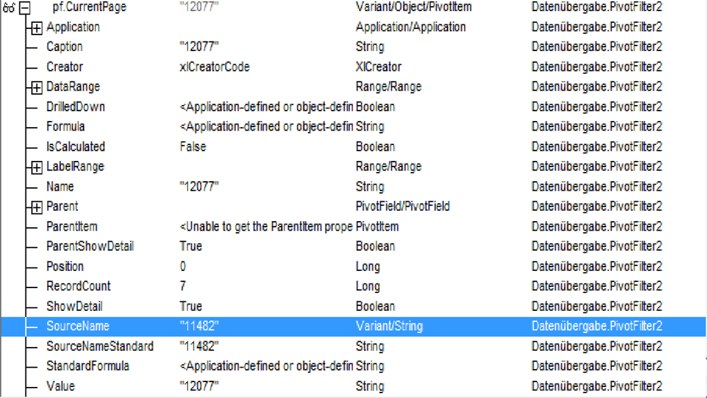

    I tried your idea, but I get still the same Problem. The command “.CurrentPage” gives me already the wrong ID. See here the pic below.
    I would like to get the data of ID 12077 but what I get is the data of 11482. Do you have another idea which does not use Currentpage but SourceName or SourceNameStandard which seems like includes the correct data?
