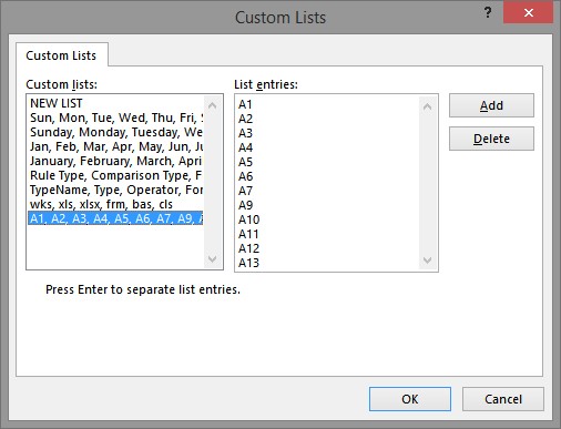

    2016-01-08T17:14:48+00:00
    I'm guessing the problem occurred when "A1" grew to the point that it added a second digit.  If not, then it probably had a Custom Sort List. To create a custom sort list, click the Sort & Filter icon and select Custom Sort.  In the Order drop down select Custom List. Enter how you want it sort like so:
    An easier approach might be to change A1 to A01. Do this for all single digit codes and then sort normally.
