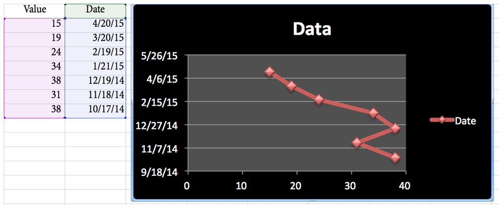

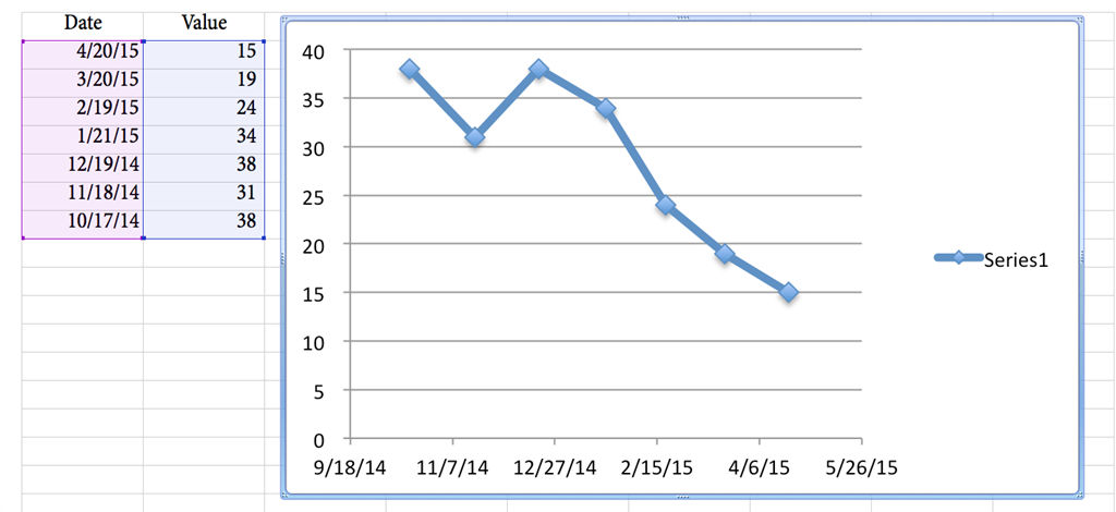

    2015-05-25T04:45:36+00:00
    Is this what you need?
    Or

    2015-05-26T00:50:02+00:00
    In sample one I put the Value after the Dates
    In sample two I put the Dates after the Values
    I tried using the button to reverse X and Y and and could not seem to get it to work so that is why I swapped position of.
    I don't normal do charts that often and therefore don't know how to set the increments which evidently rounded to nearest increment of 5 instead of 1.
    Some one Else That can do charts. (Several of the MVP's come to mind).
    Let's hope they will chip in.
