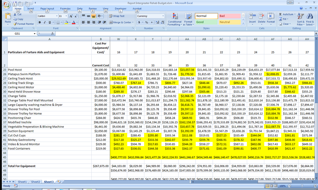

I am new to VBA's and created a VBA to calculate the highlighted cells in each specific column (see picture below).
The VBA worked but instead of returning the exact number with 2 decimal places, it returned a whole number.
see cell W47 and cell W48  both show 2 decimal places but are rounded up as whole numbers.
Cell W45 = $400,777.03 but returns $400,777.00
I want to display the exact number with 2 decimal places as currency, not a rounded up number.

Function SumColor(Color As Range, Range As Range) As Long
Dim Cell As Range
Dim ColorIndexNumber As Integer
Dim ColorSum
'Get The Color Index
ColorIndexNumber = Color.Interior.ColorIndex
'For each cell we highlighted
For Each Cell In Range
    If Cell.Interior.ColorIndex = ColorIndexNumber Then
        ColorSum = WorksheetFunction.Sum(Cell.Value) + ColorSum
    End If
Next Cell
    SumColor = ColorSum
End Function

    You must set the function to return a DOUBLE data type like this, the only change is in bold.
    Function SumColor(Color As Range, Range As Range) As Double
     Dim Cell As Range
     Dim ColorSum
         End If
     Next Cell
         SumColor = ColorSum
     End Function
