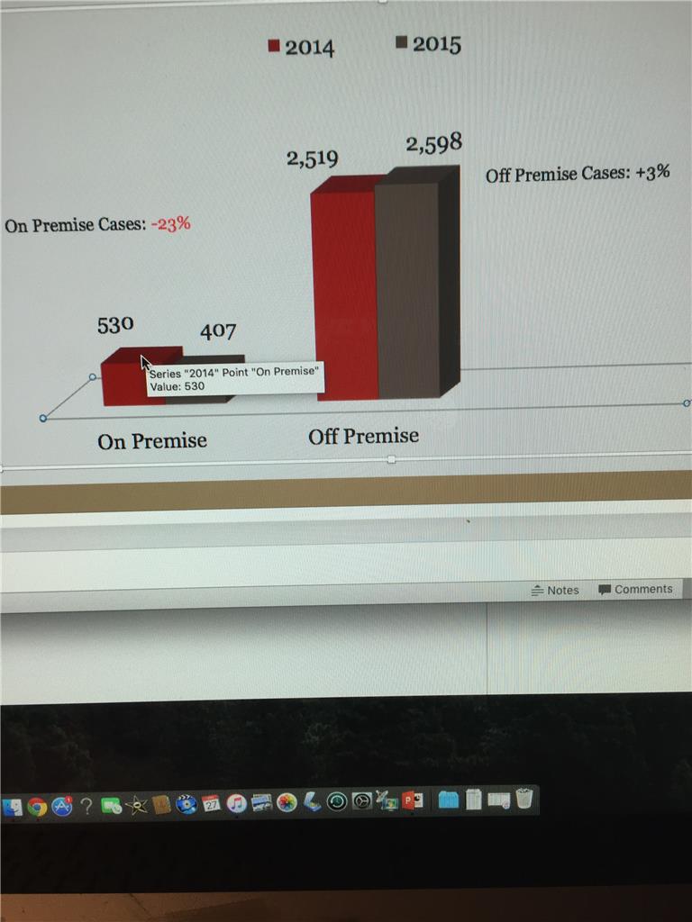

In your case, the axis has been deleted. With the chart selected, click on Add Chart Element at the left end of the Chart Design tab. Select Axes>Primary Vertical to add it back in, then you can format it.

    2016-01-27T23:16:04+00:00
    Thank you, but this still does not work.  Extremely frustrated.  Any other ideas. This is how the graphs were set up by our home company. This is what one of the charts looks like:
