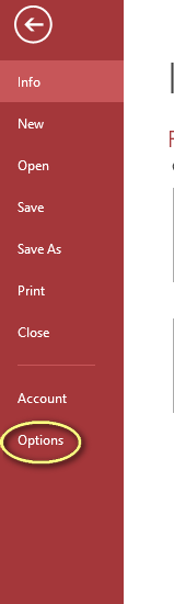

HI Folks,
after changing the ribbon using xlm and USysRibbons table, but only after running several times my application, now I'm not able any more to use the Option button in the File backstage menu. I've tried to use the Alt+T but the result it is always the same, application jumps to the main form in the Home tag. Any ideas? Thank you a lot. Gianluca

    Actually I've used the repair action from control panel (related to Office program).
    Now started again to work.
    Well done.
    Access backstage could be handled by code as well as ribbon, so I supposed it was changed by code during DB startup and pressiong shift button you are able to skip that set up.
    The main and important thing is to have the matter fixed.
      see you, ciao.
    Sandro
    2015-09-11T07:45:28+00:00
    Ciao Sandro,
    thank you for your reply.
    If will happen again to stop working I will follow your advice.
    Thank you
    Gianluca
  5. Anonymous
    2015-09-10T06:27:13+00:00
    ciao Gianluca,
    try to open you db keep pressing shift button, and the investigate what the matter is.
    Ciao, Sandro.
