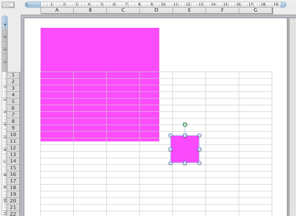

When I insert the logo into the sheet in 2011, it comes up at the correct size. But when I insert the exact same file (300dpi jpeg) into the header, it is wildly oversized (see screenshot below).
Does anyone have any idea what is causing this weird oversizing? Or if there is any way to override it?

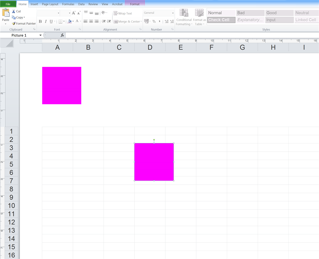

    Here's a screen grab of an image of the same print dimensions and resolution going into the header in 2010...
    As you can see, it goes in at the exact same dimensions as the image in the worksheet.
    And here is the exact same image file inserted into the same sheet in 2011...
    The only difference between the two being that in one the image is inserted via 2010 and in the other by 2011.

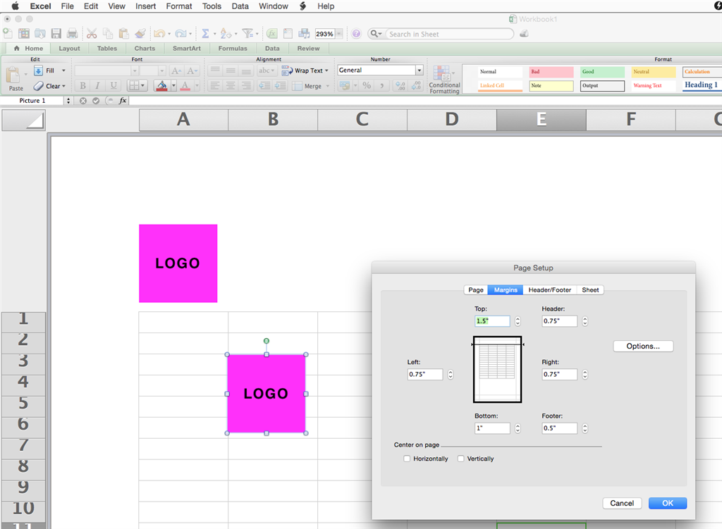

    See if something like this is what you want:  First here is an upload screen shot of the results:
    LOGO
    Now here is screen shot here will be compressed and not look as good
    Here is how I created my Test Logo
    (the Graphic program used is of no importances other than it should allow to to format in DPI/PPI) Also (The steps are somewhat generalized you do the steps in what ever you use how you get there may be different.) :
    1. Open Graphic Converter.
    2. Choose Create  > New > Image.
    3. Set canvas to 200 DPI/PPI Vertically and Horizontally.
    4. Set back Ground Color to desired color.
    5. Double Click on Text Button " A inside a square".
    6. Set desire Font Point Then type desired Text for logo.
    7. Once complete Get out of text mode and Select  the Text which will show its bounding box.
    8. Center within Canvas (background) both vertically and horizontally.
    9. Once satisfied with with results Save as a PNG.
    and be sure is set to desired DPI/PPI 300 or 150 dpi.
    Now:
    1. Open Excel sheet (Excel 2011).
    2. Click on File menu.
    3. Show header Footer.
    4. Click header.
    5. Choose custom Header.
    You will see three parts Left Justified, Center, Right Justified. Choose Left Justified. 6. click on the icon that look like a wall painting (Insert Picture). 7. Locate the Logo you just created, and Select. 8. Image should appear in Header. 9. Click somewhere in body of document, to get out of header/footer. 10. Now Double Click in Margin and Page set should appear. 11. Click on Margins set header to .75" (Logo is .67" Tall). 12. Set Top of page 1.5 "
    Now to show size of Logo I pasted a copy of the Logo in the document to create this Test Screenshot.
    You can save your Blank Sheet as a Template and send the folks the template. Al you need to send them a Copy of the logo they created. So they can add to the additional.
