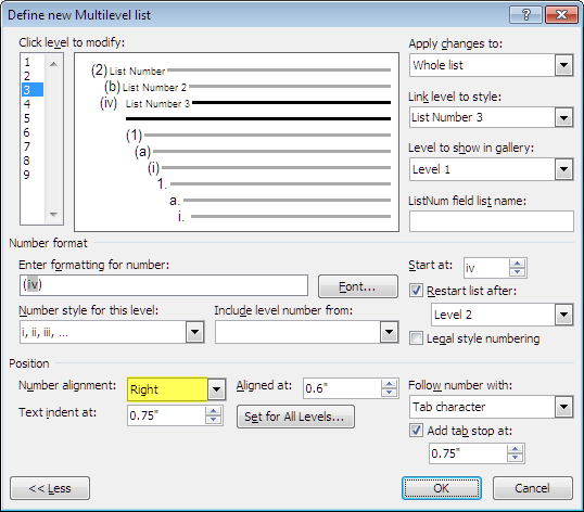

    You mentioned having problems with (iii). That looks like a roman numeral to me.
    If you are using parentheses on both sides of the numbers, then you may have to increase the indent. Here's an example of a list set up using the list format you mentioned, with added parentheses, and with the Level 3 numbering aligned right:
    This screen shot shows the Define New Multilevel List dialog for Level 3:
    As you can see, the preview in that dialog doesn't represent the indents accurately. This is largely a trial-and-error setup situation.
    If you prefer to retain the left alignment for the roman numerals, then you will need to set "Text indent at" and "Add tab stop at" to a larger amount to accommodate the longest numbers.
