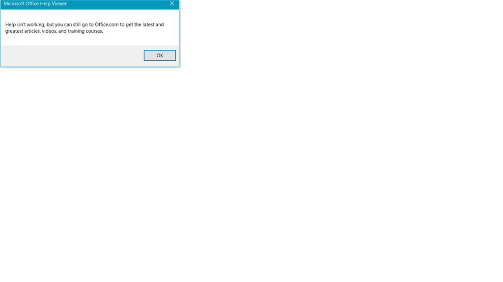

I have had a lot of problems with my installation of Office 2016.  I thought everything was fixed with a uninstall and reinstall but now I get an error that Microsoft help is noy working from the Microsoft Help Viewer. It is in multiple programs. I went ahead and uninstall and reinstalled again without fixing it.
Windows 10, 1511build 10586.11. Office 16.0.1601.1038.

I found the answer on this site--going to Internet Options in the Control Panel then clearing the browsing history and clicking to Clear SSL state fixed it.

    I've been having the same problem with the F1 and other 'help' shortcuts not working in Word 2016.  I also have another version of Microsoft Office (2010) on my computer.  I am running Windows 10.  The problem only started a few weeks ago. 'Help' still works in Excel and PowerPoint, but not in Word 2016.  I got them from the 365 package through my college.  I checked the Trust settings in Word, those are fine.  My default browser is Firefox.  In order, I tried all of the following, sometimes multiple times.
    I tried renaming the Help folder to Microsoft Help.OLD....ran a quick repair...it replaced the folder.  Nothing changed.
    I then tried running the Online repair, but it keeps telling me I'm not connected with an Error code: 30094-9.  I have been unsuccessful in finding the meaning for the error code.  The links in this error window will not work, either.  I am clearly connected to the Internet if I am able to write to you here.  I tried the 'Quick Repair' again to no avail.
    I tried updating to the latest version and restarted my computer.  Nothing changed.
    I have tried other suggestions to clear the SLL state.  My browser history was recently cleared...the problem persisted after this.
    The only thing I haven't tried is reinstalling the whole thing.  I read on here that some people tried this and it crashed the help function for the other programs by not installing a Microsoft Help folder at all.
    I really need these 'Help' functions to work.  I am in school online with limited instructor interaction.  Going to Office.com as directed from the 'Help is not working....' window does very little to help me.
    Thank you
    2015-12-04T00:18:07+00:00
    I installed the current insider build on Office 2016 and had the same trouble with Help not working. I did clear history and SSL state but the problem continued. I uninstalled and reinstalled the recommended version and things are working.
