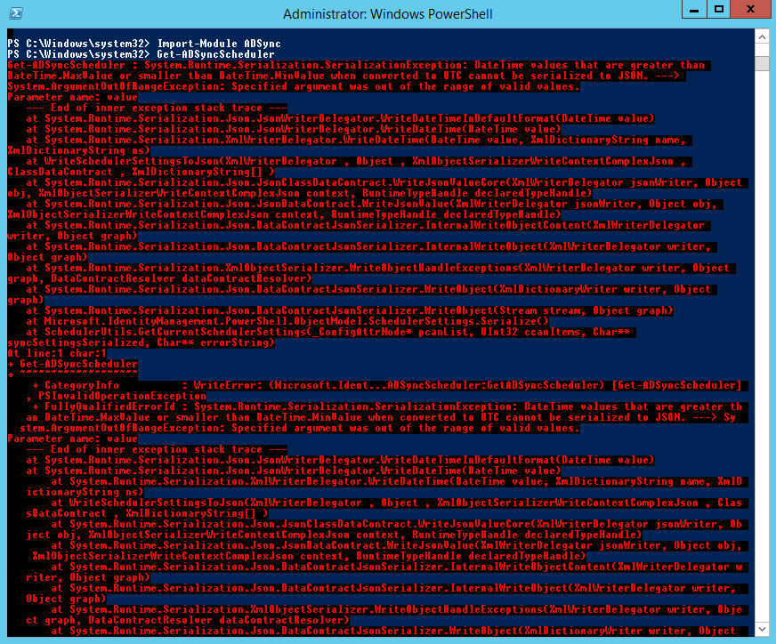

    thanks benoit, that article is very helpful (i'm now following it!!)- please keep it up! as i'm also losing faith in the support from office 365 microsoft team..
    i ran the command and it came back with nothing - so i'm assuming it's all good? after i run get-adsyncscheduler, i get a lot of red text (i'm not powershell expert)

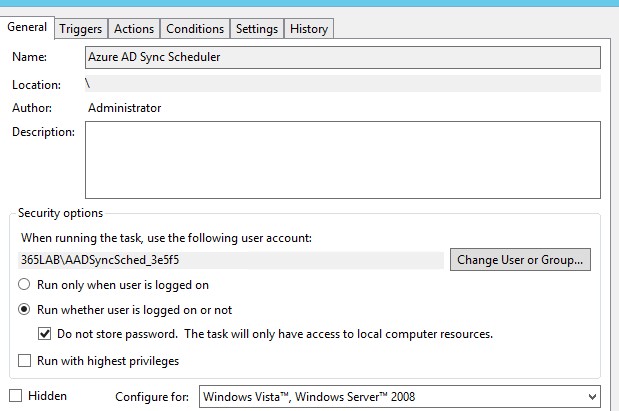

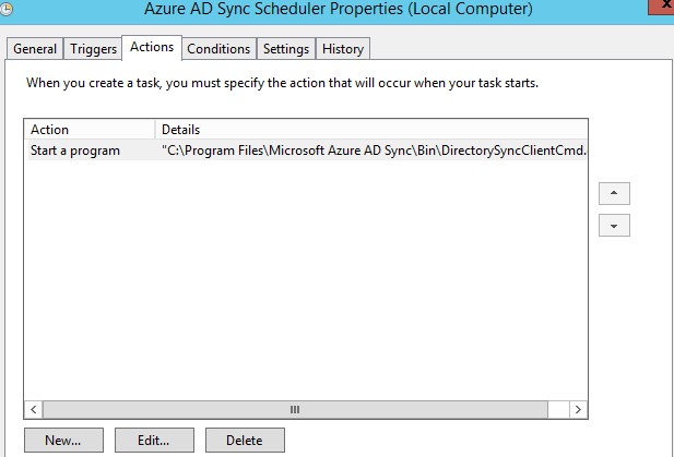

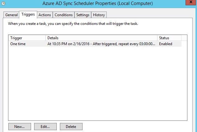

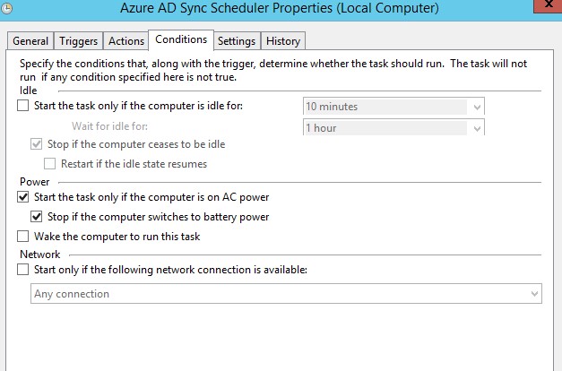

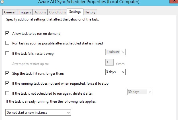

    2016-02-21T00:11:12+00:00
    hi vincenthuynh9271,
    based on my test, you can try to create a new task to get synced. please refer to the following screenshots to manually create a task to see if it works.
