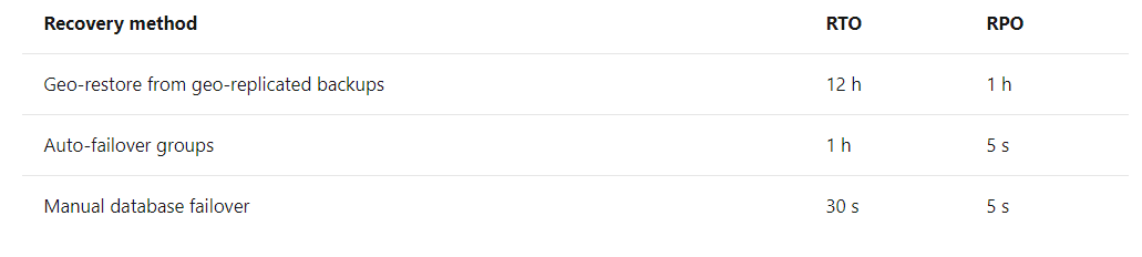

    The plan that your provided looks really good and should cover for almost all the scenarios. However you must be aware about the recovery time objective(RTO) and recovery point objective(RPO) for the business continuity. Both RPO and RTO for these recovery options have some threshold as mentioned in the below article.

    Also, the data sync for failover and geo-replication is asynchronous replication. In case of planned failover, there is no data loss but in case of unplanned failover, there could be data loss. I would suggest you to go through the below article which has ways to minimize the data loss:

    In case of outage or failure of Primary region, failover occurs only when the grace period is expired. "By default, a failover group is configured with an automatic failover policy. Azure triggers failover after the failure is detected and the grace period has expired. The system must verify that the outage cannot be mitigated by the built-in high availability infrastructure due to the scale of the impact. If you want to control the failover workflow from the application or manually, you can turn off automatic failover."
    This means system still waits for the primary region to get available because of high availability infra. Now this outage verification involves human action hence it needs sometime to come back. But for almost all cases it comes back earlier than an hour. If it does not then failover to another region happens which is 1 hour as RTO.
    If needed, we can switch off auto failover to save this grace period time and do a manual failover as it would take few minutes and switch the primary and secondary.
    Now to answer your query, yes it could take 1 hour before Server D takes over in case of auto-failover. If we switch the auto-failover off, we can set the alerts to check service health but as it involves manual failover there is a risk factor.
    Through portal we can do a manual failover. Forced failover could result in data loss as it triggers instantly while failover would make sure there is no data loss.
