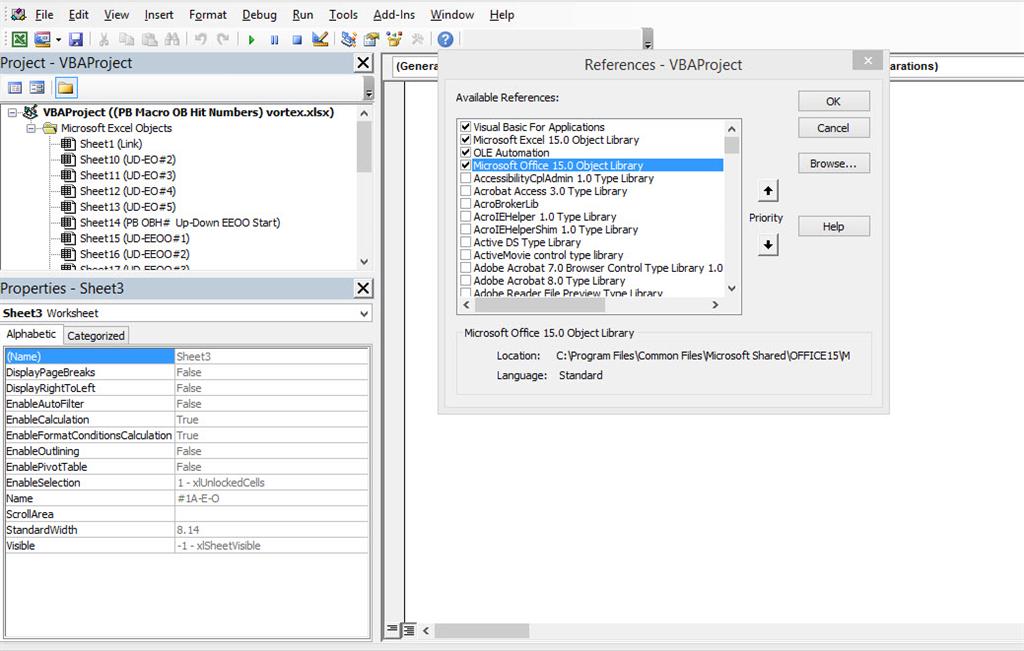

    After you get the message, go into the VBE
    In the project explorer on the left, make sure the problematic workbook is selected
    Then go to Tools=>References in the menu (in the vbe).
    You should see one or more references marked as "MISSING"
    Uncheck that reference.   (if the workbook actually needs that reference, then  you will have to find it on your drive and recreate the reference to it).

    How can I get the problematic file when it is not there.  When I get this error it will not open.  It crashes.  I deleted the exd file again but it still gives me the error
    2015-05-20T02:46:38+00:00
    Is this what you are talking about? How do I correct it if it is?
    Thanks
