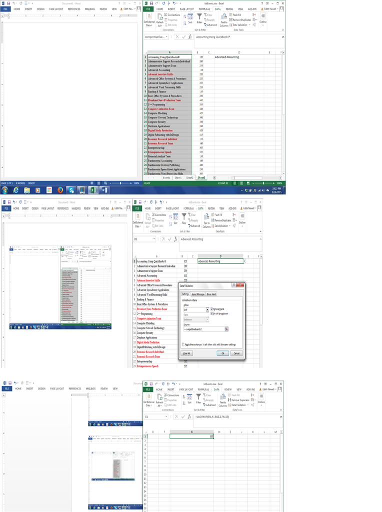

I have constructed a drop down list and vlookup to extract data.  I would like to show my data on a different sheet from the list.  How would I construct my lookup formula to do this.  i.e. List on sheet 2 and vlookup on sheet 1.

    It looks like you want:
    =VLOOKUP(Sheet3!$D$1,Sheet3!$A$2:$B$52,2,FALSE)
    or just cut G2 from sheet 3 and paste it wherever you want on Sheet1 - the formula will adjust as required.
    Thank you very much.  Part of my issue was not applying absolute references and placement of the sheet reference.  I appreciate so very much your help as it now works for me.  This will save me a lot of work as I complete the project. I have tested several selections and they all work.
    Again, thank you so very much

    Ashish - I tried your formula, but it did not work. I have uploaded screenshots of my process produced in Paint.  I hope you can read them.  In column A is my source named competitiveEvents2 A1:A2. In Column B is the event number.  Column D is a drop down list that the user can select the event the source is =competitiveEvents2. Column G is my lookup which returns the event number from the drop down list selected in D.  What I want to be able to do is have the event number show up on sheet 1.  Right now all the data and formulas are on sheet 3
