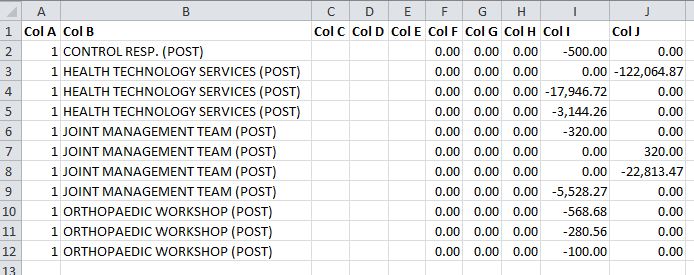

Good Day All
I am looking for some assistance please. I am looking for a macro.
I would like to insert two blank rows when the value in column B changes. In the first inserted row, the macro must calculate a subtotal of the rows above in column F, G, H, I & J. In the second inserted row it must total the subtotal above.
I have uploaded a sample of my expected outcome:- the font in italics and bold reflect the information which the macro should provide.
My document has around 15000 unique entries in column B so if possible a macro that will accomodate this.
Regards
Derryn

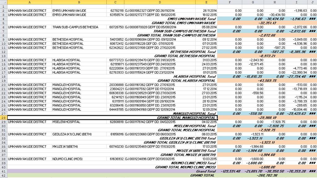

    2015-04-22T09:24:50+00:00
    Good Day All
    I used the macro provided by Andreas Killer, which went a step further by totalling the subtotals and grand totals which in effect totaled the sheet for me. Much appreciated as I didn't have to go an find a method to do this later.
    As I have multiple sheets in the workbook I wrapped it into a loop to do the function for all worksheets.
    I have however discovered a problem and all of my "basic" knowledge have not been able to resolve it. So please assist. I have uploaded the follow to illustrate my challenge.
    The macro correctly calculates the total per Column B in the rows marked in blue, it also correctly totals the total (blue) row into the orange row.
    The row colored in purple is where I find an error. The row in purple should total per column the values in the blue rows, however in column F it totals the blue and orange rows.
    Please can you assist
    Regards
    Derryn
  2. Andreas Killer 144K Reputation points Volunteer Moderator
    2015-04-22T10:25:02+00:00
    Hi Derryn,
    the issue occurs because the SUBTOTAL formula, created by Excel, in the Grand Total row includes all cells above.
    So we have to change it into a SUM formula.
    Andreas.
