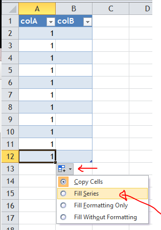

    2016-01-19T03:01:17+00:00
    Hi Mike,
    Did you see the smart tag right after dragging down?
    If you do, click on it, and select Fill Series
    5 people found this answer helpful.
