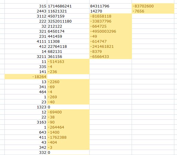

I have over 600 rows like this
I want to sort the rows so the yellow cells in each row appear in the same column.
The information in each cell can move between columns but needs to stay in the same row.
Is there a way to do this quickly through the whole data without doing one row at a time.

    2015-08-24T22:29:11+00:00
    I notice that all the yellow cells are negative numbers.
    This macro will sort rows left to right which puts all the negative numbers in column A.
    Sub Sort_Across_Columns()
    'Tom Ogilvy macro
    Dim r As Long
    Dim lrow As Long
    Dim lCol As Long
        Application.ScreenUpdating = False
        Application.Calculation = xlCalculationManual
        lrow = ActiveSheet.Cells(Rows.Count, "A").End(xlUp).Row
        lCol = ActiveSheet.Cells(ActiveCell.Row, _
        Columns.Count).End(xlToLeft).Column
        For r = 1 To lrow
            With Cells(r, 1).Resize(1, lCol)
                .Sort Key1:=Cells(r, 2), Order1:=xlAscending, _
                Header:=xlGuess, _
                Orientation:=xlLeftToRight, _
                DataOption1:=xlSortNormal
            End With
        Next r
        Application.ScreenUpdating = True
        Application.Calculation = xlCalculationAutomatic
    End Sub

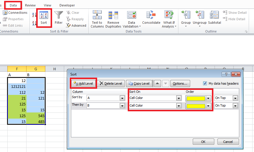

    2015-08-24T15:43:41+00:00
    Try using Sort option under Data tab on the ribbon
    It will allow you to sort multiple columns at once. You won't need to sort columns multiple times or 1by1
    But in order to bring them in one column, you will have to do add another column and go manually
