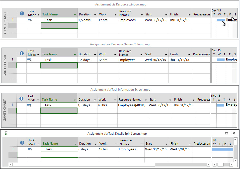

    I did not really had an answer to my problem and therefore I have further tested it. With the information I had from Jan De Messemaeker who kind of agreed that there was an issue but in version 2010, I tried the following:
    I created four separate projects (so my tests are done in parallel, to make sure they do not influence each other). And in each project I just created a task with a duration of 1.5 days and added a resource called Employees with a Maximum unit of 400%. For assigning the resource (with units=100%) to the task I used 4 different methods. Every project used another method, but every time I entered 100% for the units to assign:
    • The file "Assignment via Resource Window" used the Assign Resource button on the Resource tab. The result seems OK to me. The duration stays on 1.5 days and the work has been calculated at 12hrs.
    • The file "Assignment via Resource Names Columns" used the possibility to check the resource in the cell in the Resource Name column that you find in the view Gantt Chart. Here I did not enter 100% as it is just a check box, but the default value is 100%. The result is again OK to me. It has the same result as above.
    • The file "Assignment via Task Information Screen" used the possibility to double click on the task and to enter the resource via the resource tab. Amazingly I have entered 100% in the Units column but still it has changed it into 400%. The results for me are wrong and different from previous results. It has kept the 1.5 days duration but work has been calculated at 48hrs. I can assure you that I entered 100% but for any reason I cannot explain it has replaced this by 400%.
    • The file "Assignment via Task Details Split Screen" used the Detail information screen you obtain when clicking on the button "Display Detail Screen" on the Task tab (I used Resources and Predecessor detail screen). Here I obtain again a different result. It has changed the task duration to 6 days and has calculated work at 48 hrs. The Employees resource has units of 100%, as I entered it.
    See below print screens
    For me, whatever the reason, which I cannot explain, there is a consistency problem. At least in my version of MS Project 2013. I have used the standard options. The only thing I changed is the option to have the new tasks as Auto Scheduled for all new projects (which when just installed is by default manually scheduled).
    I am interested to know if anybody else has the same problem.
