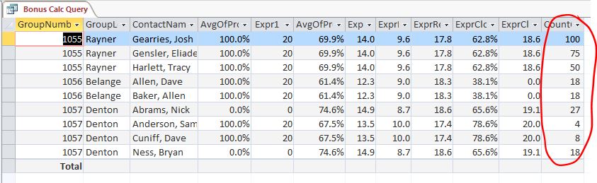

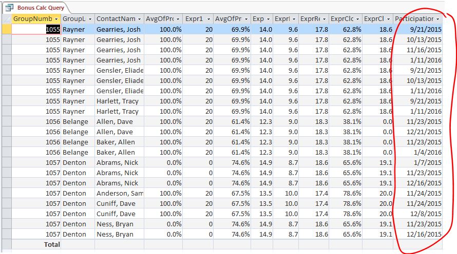

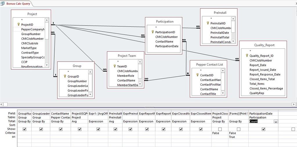

I have a database that tracks four metrics for employee bonus.  I am writing a query to summarize all 4 metrics for all employees.  I have 3 of the metrics working but the fourth is not reporting the correct values.  I need to count the total dates an employee participated (participationdate).  I added the "Participation Date" field from the "Participation" table to my query and it results in showing all of the participation dates on separate lines for each employee (as expected).  When I change the totals line to "count", the result in the participation column shows numbers I don't recognize (ie, instead of 4, it shows 100).
I am a novice and do not know SQL very well at all, but appreciate any assistance.  Below are three screenshots - the initial result before changing the total line to "count", the query design view, and the result after changing to "count".

    The COUNT operator will return the number of rows per group before grouping.  As you have other tables in the query, which in some cases will have multiple rows per participation date per contact, the count is that of these multiple rows before the grouping, hence the inflated values.  You can return a count of distinct rows by counting the number of rows in the result set of a subquery which uses the DISTINCT predicate to return one instance of each value of the column in question, e.g. the following would return the number of contacts with the same last name per city
    SELECT City, COUNT(*) AS NameCount
    FROM (SELECT DISTINCT City, LastName
                FROM Contacts)  AS DistinctName
    GROUP BY City;
