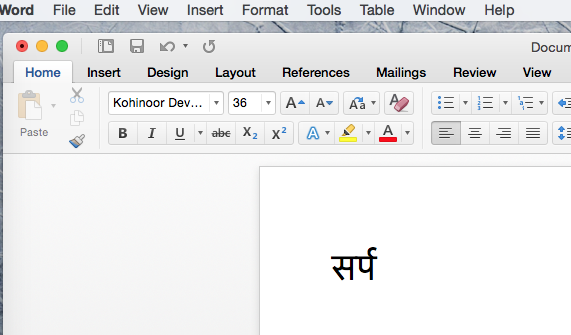

    Fredografix:  Are you using Word 2016?  I have no problem typing srfp, see below:
    2015-11-30T14:00:42+00:00
    I've encoutered the same problem as bisnubasnet did. Just choosing Devanagari-QWERTY keyboard and the Kohinoor font doesn't help. For example, if I try to type the word "sarpa", i.e. "sa", "ra"+Virama to get the "rp"-ligature, and then "pa", Word leaves me with a "sa" and an anteceding Virama. On TextEdit for example, this problem doesn't occur. I've not tested whether using a different gives better results.
