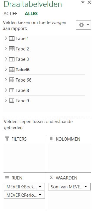

The difference between the not-working and working button is that the not-working one is a linked to a pivottable created via PowerPivot.
The difference i found is that it is linked to multiple tables (the screenshot below is the "list of fields" on the right side of your screen when targetting a pivot table (Sorry for the dutch language, but I guess you guys get the point), while a normal pivottable is not.
Though, only values from "Tabel 6" are actually used.

    I determined a way to do this regarding PowerPivot-based pivot tables.  I have three possible pivot tables on 3 different sheets, and one function for them all (called by a button on each sheet).
    .Range("B4") below is where the first column and row of the pivot table is, so you know which pivot field to collapse.
    The secret is the last line of code.  It isn't ShowDetail True/False, apparentlyfor PowerPivot it is DrilledDown True/False.
