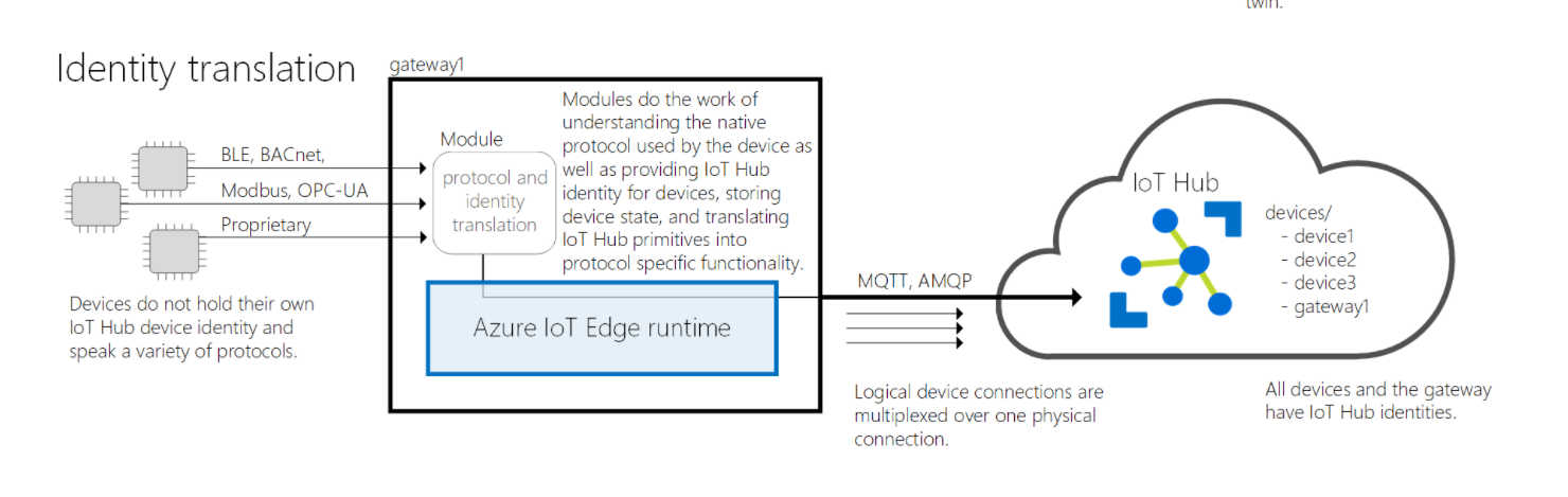

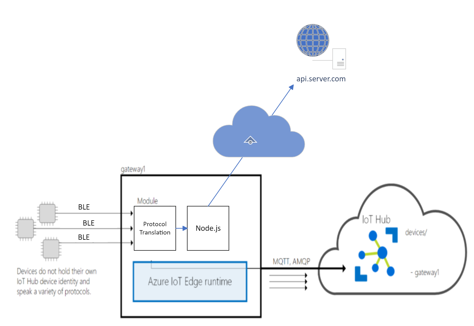

In my use case, I have a device worn by personnel that is Bluetooth enabled. As the person walks through the building I want his device to connect to BT-enabled IoT edge devices in protocol translation mode to upload telemetry data.
  1. Is there an association between leaf device and IoT Edge that prevents the Leaf from connecting to multiple IoT Edge GW?
  2. If a leaf can only connect to one IoT Edge GW in translation protocol mode is there a limit?

    You are not doing transparent proxy, you need Identity translation:
    This is something you have to create yourself:
    • Identity connections with the BT devices or incoming messages
    • Know how this BT device is already registered in the IoT Hub
    • Create a device client and send a message as being this device
