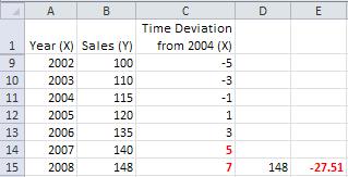

    2015-04-30T18:56:33+00:00
    Ayushman wrote:
    Year Sales (Y) Time Deviation from 2004 (X)
    2002 100 -5
    2003 110 -3
    2004 115 -1
    2005 120 1
    2006 135 3
    2007 140 3
    Its answer is wrong. It is coming to -27.51, whereas it should be Rs. 148 lakhs.
    Ayushman wrote:
    You are correct, know X and X should be year. Also, you understand correct that time deviation is 2004-2002 and so on in question 1. In second question, mid value is between 2004 and 2005. That is why, time deviation for 2004 is -1.
    In that case, I think time deviation for 2007 should be 5, not 3.  And it should be 7 for 2008.  The formula might be:  =(A9-2004)*2 - 1.
    Then, again, FORECAST returns 148 when it is used correctly.
    Moreover, I believe I know your mistake in using FORECAST that resulted in -27.51.
    Again, the formula in B15 can be =FORECAST(A15,B9:B14,A9:A14), using Year for X and knownX.
    Alternatively, you could use the formula in D15, which is =FORECAST(C15,B9:B14,C9:C14), using Time Deviation for X and knownX.
    And I believe the incorrect formula in E15 demonstrates how you got -27.51, to wit:  =FORECAST(C15,C9:C14,B9:B14).  Note that knownX (C9:C14) and knownY (B9:B14) are reversed.
