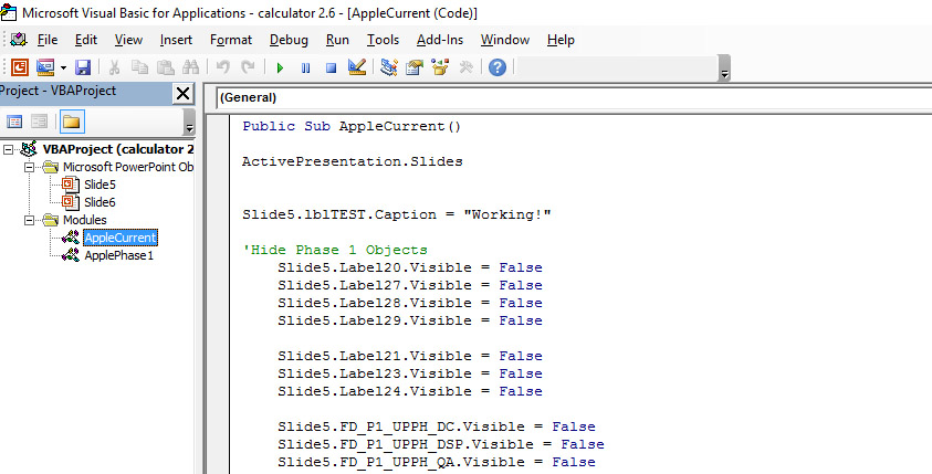

I have created a Macro (module) to handle my code, and used the Insert->action feature to invoke my Macro. However, when I go into presentation mode & click the object. The code in my Macro does not run. (I've checked this with a simple label.caption update "lblTEST")
My question is... how do I call/run (not sure the correct terminology here) my Macro? The fact that I've spent the last 45 minutes searching forums to no avail, tells me this is likely something so simple no one ever wasted time explaining it. (Historically for me, that means it's a check box option somewhere).

    1. Thanks for pointing out that line.. remnants of a failed line found on another forum.
    2.Thanks for the suggestion to post a couple slides. That actually sent me on the right track & I've figured out my disconnect. (which I'll post here in case anyone else in the world runs into this);.
    So my presentation is extremely overcomplicated (It's a calculator), and I didn't want to post ALL that Jazz.. so I opened a blank presentation, added two labels, one object & made a macro to print "It worked".
    In doing so (on this clean Slate) I realized that I didn't understand the difference between Macro's and Modules.
    I thought they were one in the same, however, I see now (And please correct me if I'm wrong so that I don't send anyone else down the wrong path), A macro appears to be a sub within a module.
    So in my case... I had named my Module the same as My Macro.
    When I changed this, it works fine.
    And yes, it didn't give me an error, it just simply seemed to ignore me :(  While that's annoying now, I can totally appreciate not sitting in front of clients with bugs popping up, Though I'd hope to catch & error proof all of that before I walk in.
    Thanks So Much :)

    John's correct; the line he mentions will provoke an error if you compile the code (which you should always do before trying to run ANY code, if only because it saves so much time and head-scratching later).
    Also, when you click on an Action button that's supposed to launch code, it only functions in slide show view (which from your question, you understand).  But also in slide show view, if there's a compile error .. ie, if the code can't possibly run as-is) PPT won't show you any error messages, it'll just quietly ignore the code.  Better to do that than to risk annoying/embarrassing messages in the middle of a presentation.

    Don't you get an error?
    The line ActivePresentation.Slides wouldn't even compile and does nothing anyway. Just remove that line and see if it helps. Otherwise you need to post a couple of slides with the macro.
