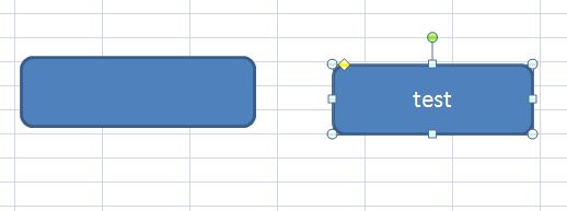

Going back to your original question you say  **"(I am using the shape as a button)".**Does this mean that you have a macro assigned to the Click event of the shape. If so, then when you click the shape it does not select but it does run the assigned code.
If above assumption is correct then you can assign as many shapes as you like to the same macro code and identify the shape that was clicked with Application.Caller.
If you want to show the shape as selected with the handles then use code within the called sub as per my example below with the Optional code line.

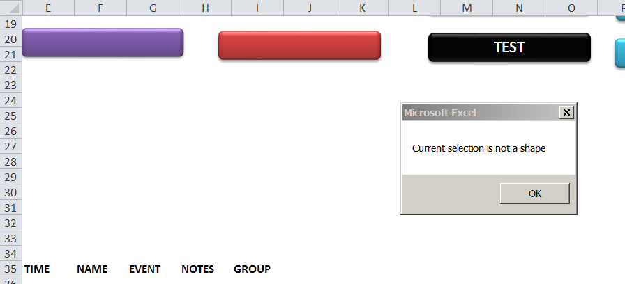

    2015-07-06T17:20:18+00:00
    I realize that when I click on the shape, the last cell that I clicked on is still selected within Excel. I assume that this is the reason. Not sure how to fix/work around this but, I'll keep trying.

    Code worked for me.
    If you had a shape selected you should see the handles.

    2015-07-06T16:30:22+00:00
    I tried this however, i got the message that this is not a shape. However, it is.
    It's reference is: Rounded Rectangle 27
