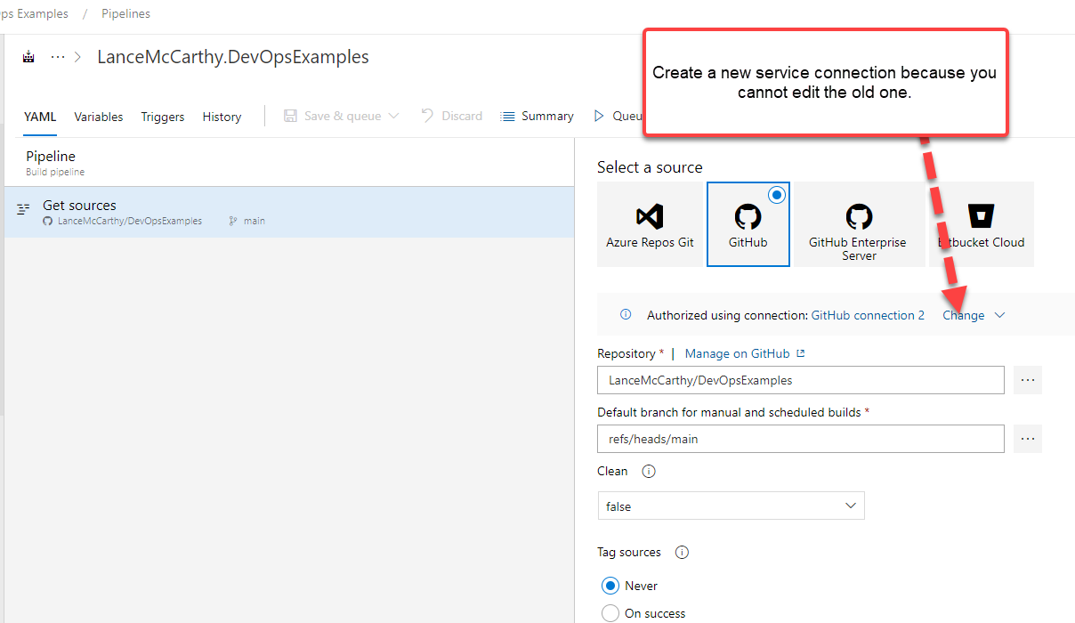

  3. Lance 311 Reputation points MVP Volunteer Moderator
    2023-06-07T15:07:37.7866667+00:00
    If you are here because of a YAML AzureDevops Pipeline failure, this happens because the authentication with GitHub has expired. You cannot create a new token because you cannot edit the expire done.
    Instead, the fix is really easy and is a two-click operation.
    1. Go to your pipeline's settings page
    2. Under "get sources" select the connection to GitHub.
    3. You'll see a "Authorized with service connection" setting. Just drop down that caret and select "create new connection.
    See my screenshot User's image
