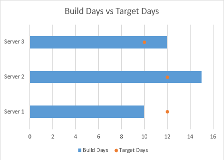

I would like to create a horizontal bar graph using the following table, with the fields "Build Days" as a horizontal bar and "Target Days" as a point.

  1. HansV 462.4K Reputation points MVP Volunteer Moderator
    2015-05-12T19:01:07+00:00
    You have to make the category axis based on values 1, 2, 3.
    When you change the chart type for Target Days to XY Scatter, switch the X-values and Y-values.
    Then make the secondary vertical axis run from 0.5 to 3.5 to match the layout of the primary vertical axis.
    Finally, delete the secondary vertical axis.
    See the sample workbook at https://www.dropbox.com/s/v8oojvaxo7k02fj/CombiChart.xlsx?dl=1

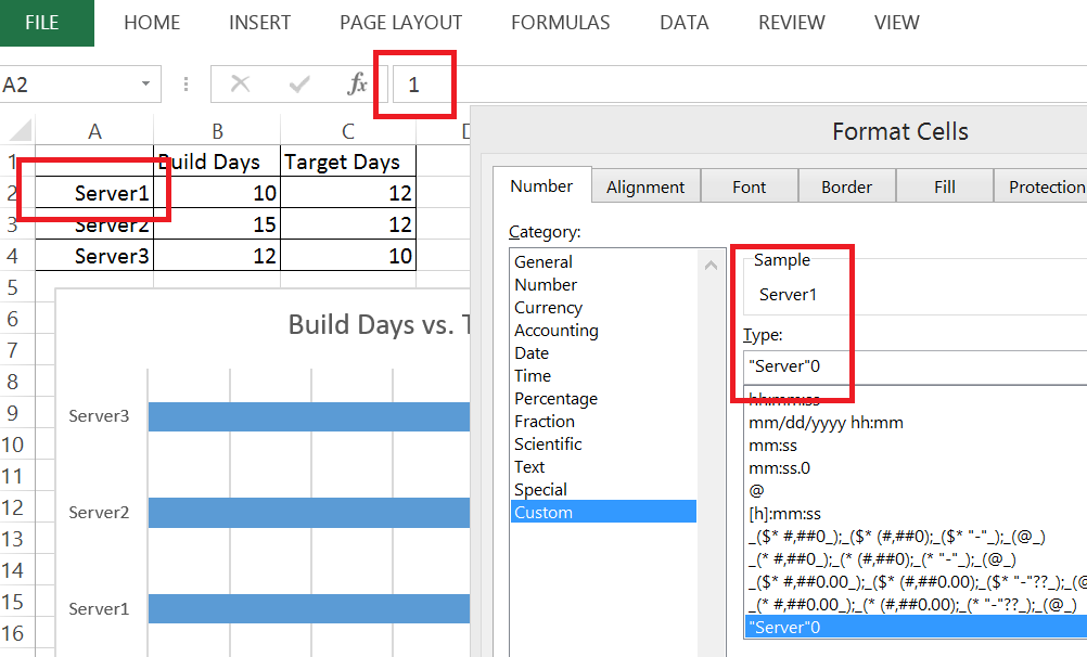

    2015-05-13T02:50:38+00:00
    Thanks much. Took me a while to figure out that "Server 1, 2, 3" were customized formatted cells...
