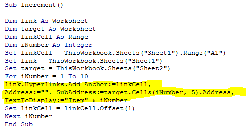

I'm new to VBA, but I feel like there's an easy fix here. The first part of the code works. I need to create a long range of hyperlinks that link to corresponding cells in a different sheet. every thing works well, except it wont link to sheet 2. Please Help.

    Please don't use pictures to post a code, nobody can copy that into the VBA editor (modify and test the code).
    The Address property (without arguments) of the Range object returns a string of the cell only ($A$1) regardless in which sheet the Range is located.
    The property has also a External argument, set it to True to get the full qualified address of the cell.
    Address(External:=True)

    Thank you.  This is my first time asking any kind community for help, so I'm not sure what I'm doing, I usually just google search for hours until I cab find what I'm looking for. so please exucuse my ignorance, but here is the code again. hopefully you or somebody can help me.
    Sub Increment()
    Dim link As Worksheet
    Dim target As Worksheet
    Dim linkCell As Range
    Dim iNumber As Integer
    Set linkCell = ThisWorkbook.Sheets("Sheet1").Range("A1")
    Set link = ThisWorkbook.Sheets("Sheet1")
    Set target = ThisWorkbook.Sheets("Sheet2")
    For iNumber = 1 To 10
    link.Hyperlinks.Add Anchor:=linkCell, _
    Address:="", SubAddress:=target.Cells(iNumber, 5).Address, _
    TextToDisplay:="Item" & iNumber
    Set linkCell = linkCell.Offset(1)
    Next iNumber
    End Sub
  3. Andreas Killer 144K Reputation points Volunteer Moderator
    2016-03-03T15:11:55+00:00
    As I said: External:=True
    Andreas.
    Sub Increment()
          Address:="", SubAddress:=target.Cells(iNumber, 5).Address(External:=True), _
      Next
    End Sub
    2016-03-03T15:40:59+00:00
    Thank you so much! it works perfectly. I have no education in VBA so I'm teaching myself. I actually took sections of 3 different codes to paste this code together lol. When you mentioned "Address(External:=True)" I had no idea where to put it, so thanks again and have a good day.
