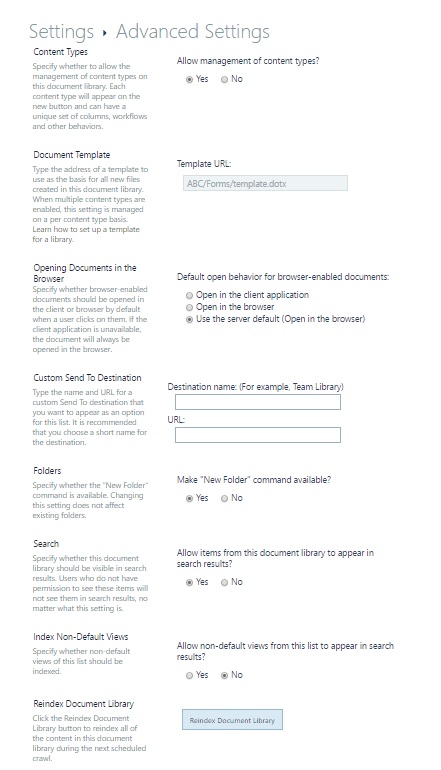

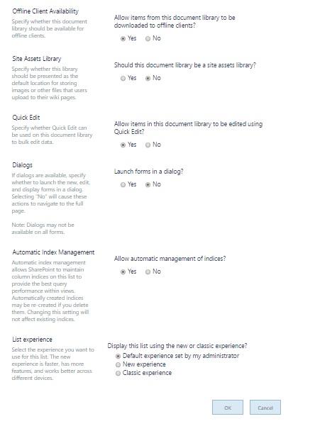

I have created a custom document library and added few custom metadata (5 additional custom metadata) to it. The document library works good via web browser however when I use Sync tool, I can sync the document library using 'Sync' icon but all files and folders appears to be in read only mode and comes up with green lock.

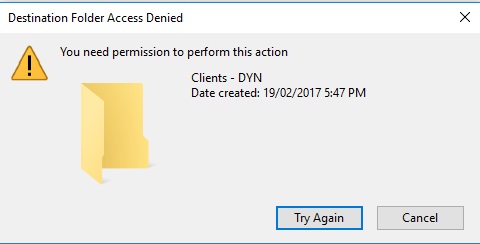

When I copy file after sync, the error message I receive is:
The advanced settings for document library are:
I don't get the issue when I use default document library. I have checked the permissions as well but it is not a permission issue as I have full access to the site and document library.

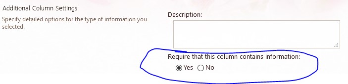

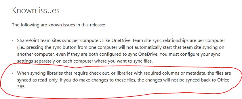

    2017-02-20T10:38:16+00:00
    Hi Mitesh,
    Yes, if your metadata column keeps having “require that this column contains information” setting, you even have no permission to put a new created document to your local sync folder. The only way to solve this problem is change the setting from yes to no.
    Thanks,
    Rena
    2017-02-19T11:07:06+00:00
    Hi Rena,
    Thanks for letting me know.
    I also can't add any new files or folder in the document library contains custom metadata via Synced location. Is this also a known issue? I am new to SharePoint sync and not sure whether it used to work or not.
    My Current SharePoint sync tool version is 2016 (Build 17.3.6798.0207).
    Could you please provide more info?
