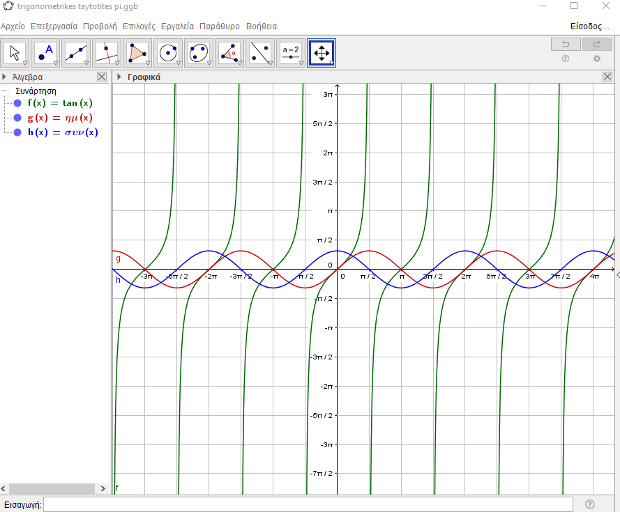

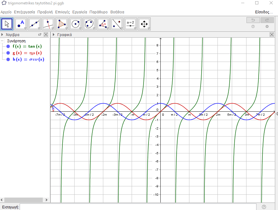

    there is a mathematical application, called Geogebra
    pic.
    pic2
