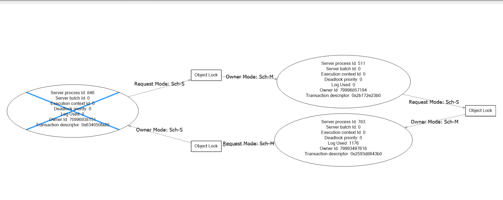

We have a table where we're updating a table column, increasing the 3length of an NVARCHAR column, but results in DEADLOCK

Not sure why this is happening. It's variable and if we try a few times, it eventually updates. The confusing part is, if we're just updating ONE table, how is it involved in a DEADLOCK? The assumption is that it should only be locking the ONE table, but it has to also be locking other tables or there could not be a DEADLOCK. Our DBA thinks it's also locking tables that use the primary key of this table as a foreign key, and that would explain it. If that's the case, is there a way around this?
EDIT: Adding what a DBA sent me when I asked for deadlock trace:

    I don't fully understand this deadlock, but a key factor is that the ALTER TABLE statement also wants to take a log on the DB_Name_Obfuscated.dbo.PrefixObfuscated_Merchants. Why I don't know, but may be there some dependency.
    The first reader process runs a join against merchants and merchants (and more tables). For the second reader process, the statement have been truncated, so we don't see all, but it may be something similar.
    Both reader processes are running with NOLOCK/READ UNCOMMITTED. Despite the mode, process do still take locks in this mode, to wit a Sch-S, Schema-stability, locks. While they can live with the rows changing while they are reading, they don't want the schema to change.
    The ALTER TABLE statement on the other hand, wants a Sch-M, schema-modification lock, on both tables. It is obvious why this is needed on Organization, less so on Merchants. The ALTER TABLE first takes the lock on Organization, whereas the read first gets a lock Merchants, and then they try to take the lock they want on the other table, blocking each other.

    I am wondering, in our case (see below), why this could cause a deadlock. It's a really quick ALTER TABLE statement on a non-primary key. I assume that the only table being locked is Organizations, so Process A, running the SQL below, locks the table, but if one or more other processes are trying to insert/update/delete from Organizations, how could this result in a deadlock? Process A either got the lock or it didn't, and if it didn't then it would just have to wait to get it.
    ALTER TABLE dbo.[Organizations] ALTER COLUMN [AckOutputFileName] NVARCHAR (255) NULL
