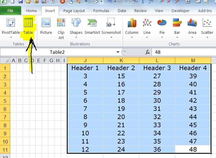

    Select your table, with the headers, and choose  Insert / Table

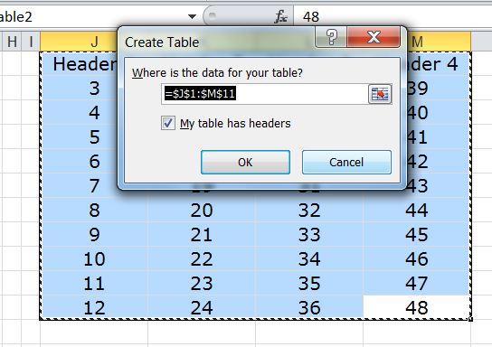

    Make sure you have "My table has headers" checked, then press OK

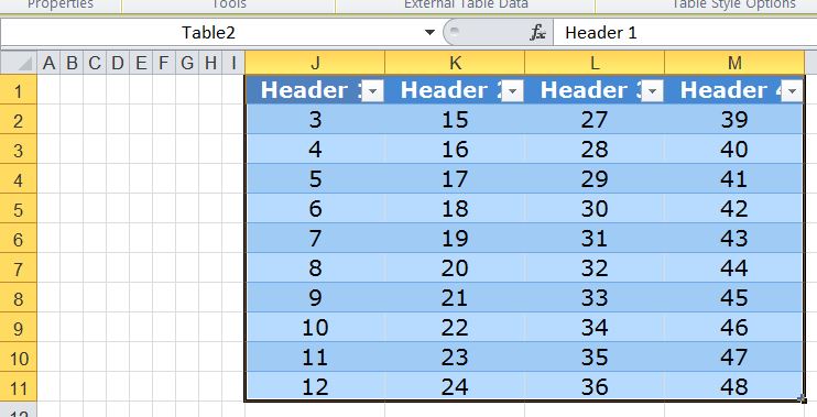

    Your range will be converted to a table:

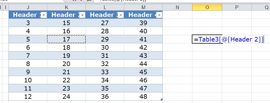

    And when you reference cell K4, you will get the table-style reference:
