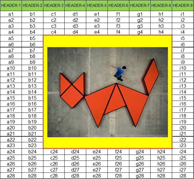

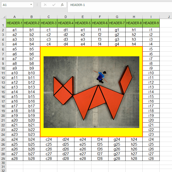

    in the sample below
    I have a range A1:I29
    pic1
    if you select the range A1:I29 and run the code,
    you have this (picture on desktop)

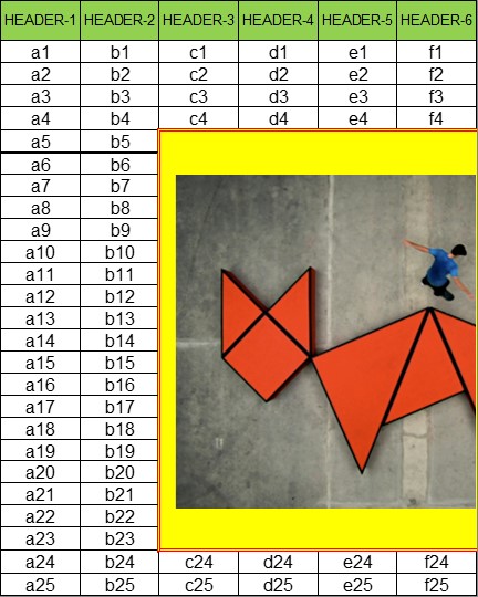

    pic2
    if you select the range A1:F26, expected result is as follows (picture on desktop)
    pic3
