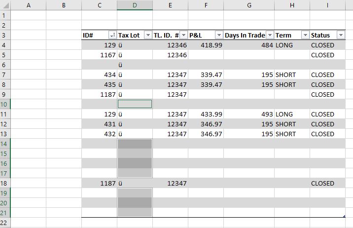

I am trying to write code to delete empty rows on a work sheet. it was setup buy recording a macro.
when I recorded it worked fine, when I ran the code I get run time error    "1004"
why wont it work as recorded?
Sub Macro11()
    Range("Table16[Tax Lot]").Select
    Selection.SpecialCells(xlCellTypeBlanks).Select
Selection.EntireRow.Delete
End Sub

2016-10-15T04:17:08+00:00
Run time error 1004 is a generic error.  When you get the error and click Debug, which line is highlighted in yellow?
Most likely - The macro was already run and all the blank rows have been deleted, therefore there are no rows to select or delete, hence the error.
One way to handle this would be:
    On Error Resume Next
    Selection.SpecialCells(xlCellTypeBlanks).EntireRow.Delete
This is not the best solution but it should work in your situation.  There are much more sophisticated ways to trap errors, but lets not get too fancy, but here is another:
    If Err = 0 Then
    End If

    2016-10-15T13:15:27+00:00
    so this is what I have, it selects the blanks but doesn't delete the rows. I wonder if it has something to do with the fact I am trying to apply this to a table?
    The code did run without errors.
    Sub Macro11()
    If Err = 0 Then
    End If
    End Sub
