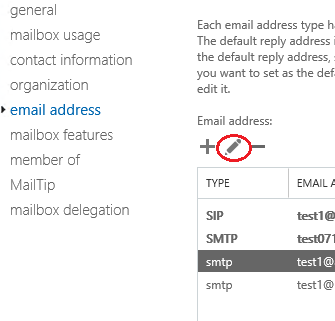

Here are the steps:
In the EAC click recipients> mailbox> select the mailbox where you want to change the primary email address, then click Edit.
Choose the secondary address in email address, then click Edit
Check Make this the reply address box.
NOTE: This action won’t change Skype for Business address ( SIP address), so your email address will be different from it if you don’t change back. Also some functions in Outlook and Skype for Business will be affected such as Skype meeting. So I suggest you change it back after you finish searching.
