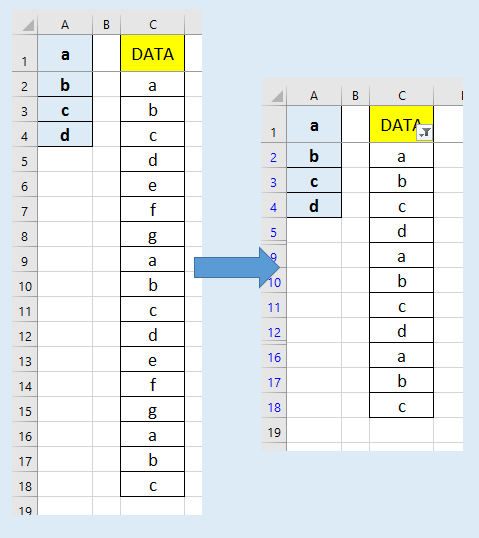

    try this sample, using vba macro

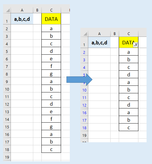

    method1
    multiple criteria, in cell A1 (comma separated)
    data in range C1:C18
    vba macro
    Sub AutoF_MultipleCriteria_InOneCell()
    'Aug 31, 2016
    Dim ws As Worksheet
    Set ws = ActiveSheet
    ws.AutoFilterMode = False
    Dim rng As Range
    v = Split(ws.Range("A1").Value, ",")
    Set rng = ws.[C1:C18]
    rng.AutoFilter Field:=1, Criteria1:=v, Operator:=xlFilterValues
    MsgBox "next"
    End Sub

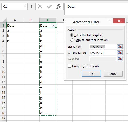

    You may use Advanced filter also for this which I believe is more convenient.
    My data is in column C while my criteria is in column A.
    See this snip shot.

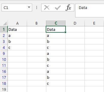

    This is result after applying OK.
