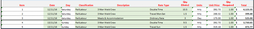

All,
I want to copy a table A with dynamic number of rows
But on the table where I want to copy there will be only the three columns - item, description and total.
Is there a way to do that - with or without VBA
Also, if possible , I  am willing to insert a new line - after each date and put a date there. Some-thing like below for the output table

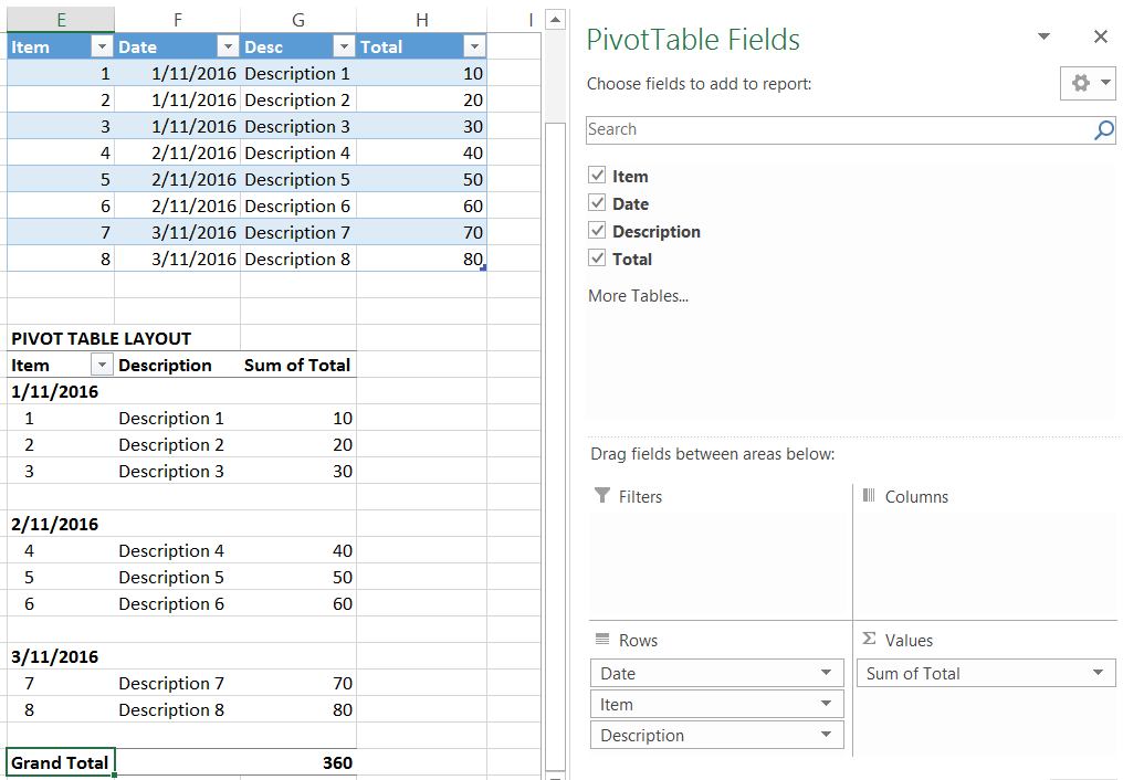

2016-11-17T23:20:56+00:00
See below,  but the main thing is to have Date as the first row label and then Item and Description
Click in the Pivot and from the menu select Design > Report Layout > Tabular
Then Design > Subtotal > Do not show subtotals
Then in the Pivot Right Click on one of the dates and chose Field Settings > Layout & Print >
Click the check box "Display labels from next field in same column"
Click the check box "Insert blank line after each item label"
Here's a link to a file with the type of layout you are looking for
https://dl.dropboxusercontent.com/u/87775834/Excel%20Community/Pivot%20Layout.xlsx

    Thanks.
    It really works as intended.
    Also excited and amazed on the power of excel - if you know it its really endless the way you can use it, even without VBA.
