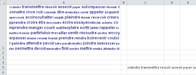

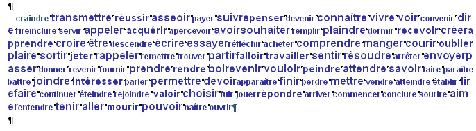

I ran the code Rick, but it only put all text from A1 in C5, see below.
Below that result I showed how the text looks in Word, with the non printing characters (formatting marks) showing, maybe they cause the problem?
The only thing I can think of is that after you copied the text into cell A1, the things you think are spaces between words are not actually space characters (ASCII 32). Just a guess, but they may be non-breakable spaces (ASCII 160). Try copying the text from Word without the formatting marks showing and see if that makes a difference. If not, then see it this fixes things....
    Jack.
