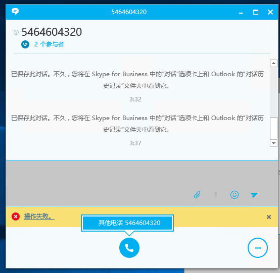

when I trying to use Skype for Business Client call Asterisk, let's say, call 5464604320:
client responsed with 'No response from server' .
