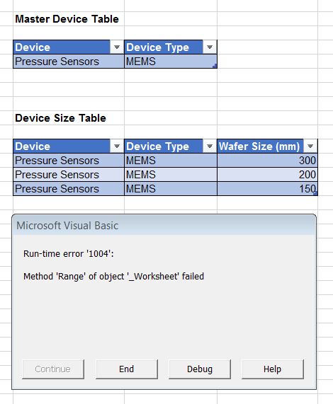

    "Run-time error '1004': This operation is not allowed. The operation is attempting to shift cells in a table on your worksheet."
    The reason for this error is that the table below has 3 columns and the top table has 2 columns.
    If you add a row to a table using ListRows.Add means only 2 cells are inserted into the sheet in this case, which would destroy the table below.
    The solution is to insert an entire row and resize the table.
    Andreas.
    Option Explicit
    Sub Main()
      AddTableRow ActiveSheet.ListObjects(1)
      AddTableRow ActiveSheet.ListObjects(2)
    End Sub
    Sub AddTableRow(ByVal Table As ListObject)
      Dim R As Range
      'Get all cells in this table
      Set R = Table.Range
      'Get the bottom right cell
      Set R = R.Resize(1, 1).Offset(R.Rows.Count - 1, R.Columns.Count - 1)
      'Insert a row below
      R.Offset(1).EntireRow.Insert
      'Resize the table
      Table.Resize Range(Table.Range, R.Offset(1))
    End Sub

    Your solution definitely makes sense, to add an entire row & resize FIRST before adding in the rows. I started learning VBA this week, so I am new to the debugging. I am getting a run-time error that reads "Method 'Range' of object '_Worksheet' failed."
    Note the picture below is already populated with values, I was trying to insert a new device & got the error:
    From this line of the code you specified:
    I was wondering if you had any thoughts on how to fix this?
