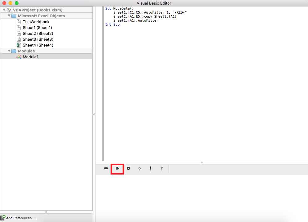

    Hi Aaron,
    Based on your description, you would like to copy an entire row if column C contains the specific criteria. I suggest you use VBA code to achieve it. You can f as below.
    1.    Go to Developer, click Visual Basic under Code.
    2.    Add the code below. For example, rows which contains RED in Column C in Sheet 1 will be copied to Sheet 2.
    Sub MoveData()
    Sheet1.[C1:C5].AutoFilter 1, "*RED*"
    Sheet1.[A1:E5].copy Sheet2.[A1]
    Sheet1.[A1].AutoFilter
    End Sub
    3.    Click Run.
    For more details: Create a macro in Excel 2016 for Mac.

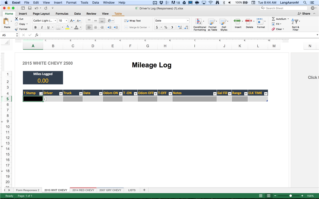

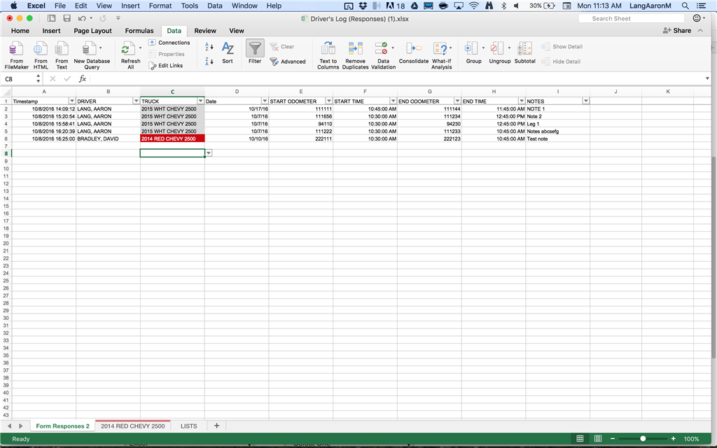

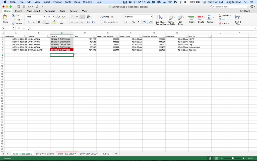

    2016-10-11T15:50:51+00:00
    ... You need a VBA program to do what you want to do...
    - I was figuring that's the conclusion. What would you recommend?
    If you want some specific help, you'll have to be a lot more specific about what the data looks like, what the sheets for each truck look like, where does the row from the original sheet go in the truck's sheet - (next row, specific row, what about duplicates) etc. etc.
    - Here's a screenshot of a both tabs. I edited the truck's tabs for appearances, but they don't need to be formatted this way. Each of the truck tabs are identical, minus title in the headers. I kept the columns the same globally to make it easier. The end goal is to separate all data entered in sheet 1 (auto-populated from an app) onto the nicer looking truck tabs for reporting purposes. If I can get that figured out, I'll do the same by driver at some point as well. Either way, I imagine it would be the same process.
