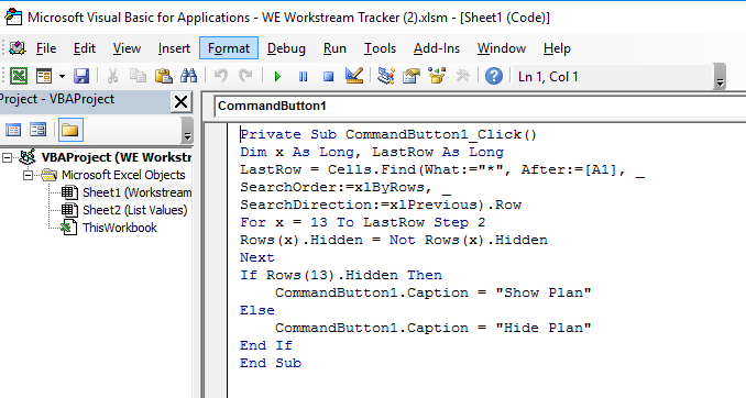

    2017-03-09T17:08:32+00:00
    Hi, Mike.
    I'm sorry to make a private tutorial public, but I hope this helps others. And I appreciate your time.
    Is there somewhere else I need to assign the button name. (By the way, I changed "11" to "13" in the script because I moved the first Plan row to Row 13. If the original "x=11" wasn't meant to indicate  the first Plan row, let me know.)

  5. Anonymous
    2017-03-10T10:33:28+00:00
    I cannot see any reason why that wouldn't work. I've uploaded a working version to my Onedrive, it's called Hide_Show_Plan.xlsm Have a look and see if it works for you.
