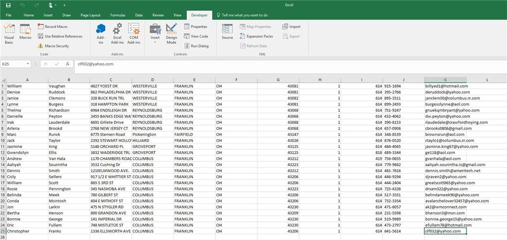

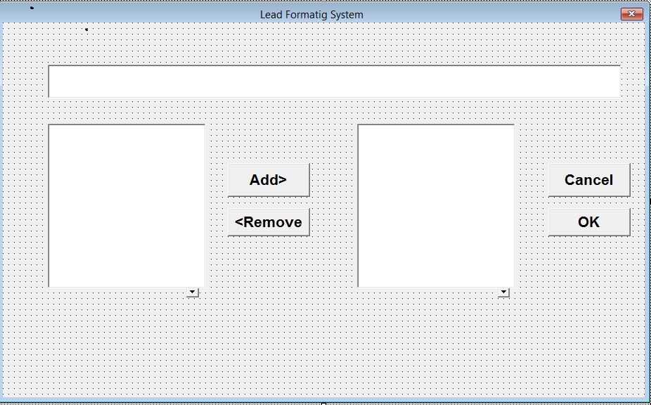

To Whom It May Concern:
I was given an assignment by my manager to write a VBA program, using Excel 2013 on Window 8.1 to interrogate a file's content to determine what is on it and then format it in a specific company format. Above it is a sample of what is contained on the file.
From this, the user uses the below listboxes to tell what is in each field.
The textbox tells the user what the next field in the file it seeks information on. In order to accomplish this task, there has to be a dialogue between the main module and the listbox routine if the program is to work correctly. The problem I am having is when the user selects (or click on “ADD”) for the first field in the file, the program performs the code for the ADD togglebutton and then stops (See below). It doesn’t continue the processing so the user can tell the system what the next field in the file is. What do I need to do to have the system to continue processing after the user makes his first selection? The code that I am using is below to create the dialogue MAIN routine and LISTBOX routine. I trust that I was descriptive enough. I apologize if I wasn’t.

LISTBOX ROUTINE:

Private Sub UserForm2_Initialize()
   With Me.FieldSel_lbxSelect
       .RowSource = ""
       .AddItem """1"" - Salutation"
       .AddItem """2"" - Title"
       .AddItem """3"" - Full Name"
       .AddItem """4"" - First Name"
       .AddItem """5"" - Middle Name or Initial"
       .AddItem """6"" - Last Name"
       .AddItem """7"" - Surname"
       .AddItem """8"" - Address 1"
       .AddItem """9"" - Address 2"
       .AddItem """10"" - City"
       .AddItem """11"" - County"
       .AddItem """12"" - State"
       .AddItem """13"" - Zip Code"
       .AddItem """14"" - Area"
       .AddItem """15"" - Country"
       .AddItem """16"" - E-Mail"
       .AddItem """17"" - Company"
       .AddItem """18"" - Phone country code"
       .AddItem """19"" - Phone area code"
       .AddItem """20"" - Phone number"
       .AddItem """21"" - Fax country code"
       .AddItem """22"" - Fax area code"
       .AddItem """23"" - Fax number"
       .AddItem """24"" - Mobile country code"
       .AddItem """25"" - Mobile area code"
       .AddItem """26"" - Mobile number"
       .AddItem """27"" - Messenger"
       .AddItem """28"" - Homepage"
       .AddItem """29"" - Social Networks"
       .AddItem """30"" - Birthday"
       .AddItem """31"" - Notes"
       .AddItem """32"" - Origin"
       .AddItem """33"" - Campaign"
       .AddItem """34"" - IP address"
       .AddItem """99"" - Extraneous Data"
   End With
   FieldSel.Show
End Sub
Private Sub FieldSel_TgbAdd_Click()
   If FieldSel.FieldSel_lbxSelect.ListIndex = -1 Then
      Exit Sub
   End If
   For I = 0 To FieldSel.FieldSel_lbxSelected.ListCount - 1
       If FieldSel.FieldSel_lbxSelect.Value = FieldSel.FieldSel_lbxSelected.List(I) Then
          Exit Sub
       End If
   Next I
   module1.intColumnCategory = FieldSel.FieldSel_lbxSelect.ListIndex + 1
   FieldSel.FieldSel_lbxSelected.AddItem FieldSel.FieldSel_lbxSelect.Value
   module1.blnAdd = True
End Sub ****The processing gets to point and then stops for no apparent reason on my part. I want processing to continue so it will go back to the MAIN ROUTINE.****
